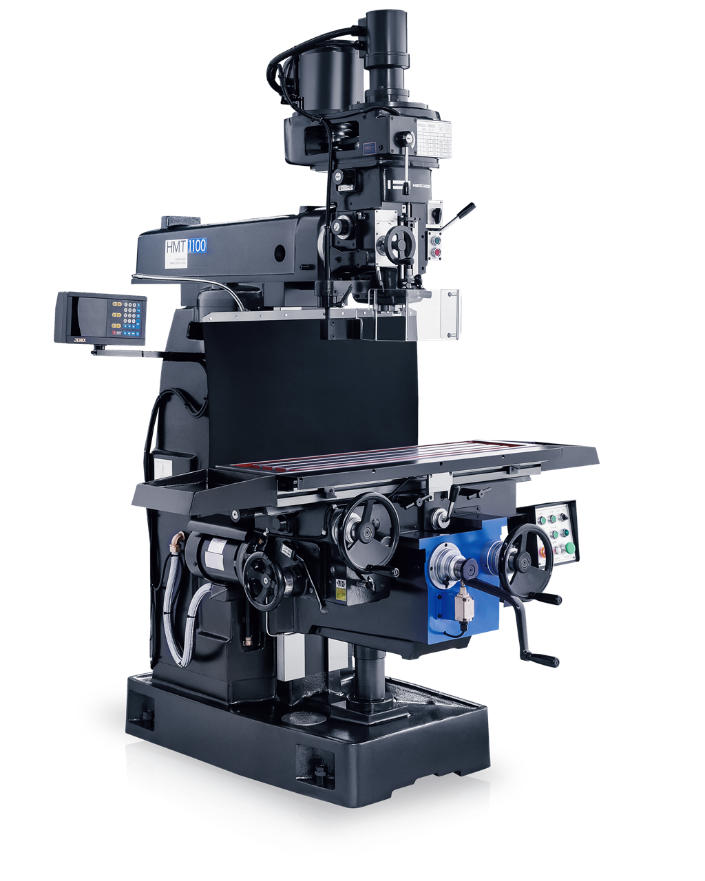

HMTH-1300 is a manual lathe that has been trusted and loved for a long time based on precision and best performance.
HMTH-1300 provides a product line-up and optional specifications that can respond to various customer needs, and maximizes user convenience for easy and convenient use.
